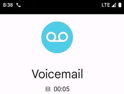

@softech the earlier screenshot was mine. I think hycm53 was just quoting my message and asking a question.

If you see LTE or 4G on your screen when making a call, you have VoLTE (voice over LTE). If you see 3G when on a call, you don't.
So I have to turn off WIFI and get LTE, why is that? I don't understand.
@hycm53 with your earlier screenshot, you see LTE when you are on a call, it is on VoLTE
another thing to check, go to Setting->About Phone -> Status information->Sim card status, if you see IMS registration status showing Registered, you are Good

@hycm53 many phones will not show the network details if you're on WiFi. Your phone should be on LTE, but if WiFi is connected, you'll just see cellular signal bars without any text.
The recommendation to turn off WiFi is only to help you recognize what network you're connected to.
During an active voice call, as long as you're on LTE, it means you're using VoLTE.

@hycm53 is on a VoLTE call.  The bars/signal strength don't need to be checked when there's an LTE indicator on the screen.  The LTE icon would change if the call wasn't using VoLTE.

@hycm53   yes, you are on VoLTE as the network is still showing LTE and didn't drop to H or 3G
