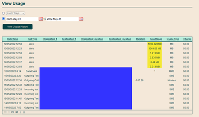

05-15-2022 09:55 PM - edited 05-15-2022 11:21 PM
@douglasmcneill the main question is where that 1000.828 MB went. It was from before and iPhone has no easy way to track back if you didn't reset your device data use on May 1.
There are different reason why there could be a 1GB usage, could be app update, could be OS update, could be video streaming. You might or might not notice any of those happened. Also, iOS has Wifi Assist that will trigger data if it sees a very weak Wifi signal, so was that setting tuned on?
I suggest you to reset your iPhone Data tracker today and start monitoring it daily and see if there is any discrpency.

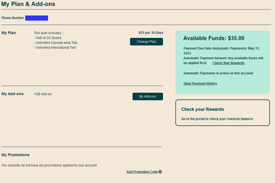

As per the advice on this thread I changed my plan on the 1st May 2022. I reset my phone then and it says I have used 1.3Gb of data. I can also go into the Public 'View Usage History' and see the following (sorted by 'Data Usage'
and this is my plan:
05-15-2022 09:46 PM
@douglasmcneill wrote:I have an iPhone. It says I have used 1.3Gb. The Public usage says I have used 1.3gb. My plan says it is a 3gb per month plan.
@douglasmcneill for iPhone, you cannot easily track backward
But at least you can try to Reset the data usage tracker today and start track today. Then you can go to PM and compare the usage daily
Check this:
So, reset it today on your iPhone. Take a note on PM and see how much it shows you, I believe 1.3GB for your current usage
Then tomorrow night , check your iPhone and PM usage and see if they match. Your iPhone track will also show you which app used the data and how much. Then you can tell if PM was correct or if your iPhone needs to tighten up the app data usage
