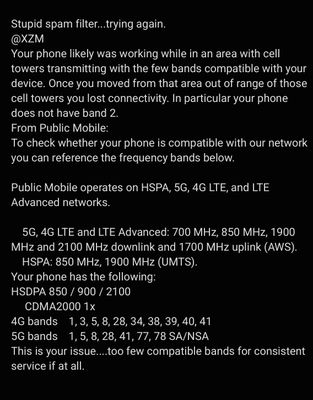

because yours is not a Canadian model, your phone has some bands but not all. It needs to hane at least couple compatible bands for a stable connection as not all network sites have all the bands

hi @XZM different operators need phones with different network bands to work in their system
your phone does not have the proper network bands needed here
I am afraid you need to get another phone to use it with PM network
(your phone might work with Rogers network, but PM uses Bell/Telus system and has different requirements)
