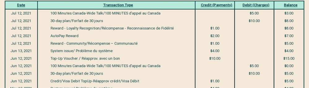

Here's the timeline when this occurred to the bf's account. I didn't take a screenshot after I fixed it. The difference here was there was system maintenance the night of his renewal and when I went to add the voucher both the site and 611 was down.
I was able to add the voucher just before 3am pt to avoid suspension and reactivate via lost/stolen. I allowed it to remain in the "limbo" state for 4 days to see if it would fix itself....when it didn't I suspended service again to get it to display the correct dates and $ amounts.
Note: The plan charge was in the transaction history but after payment it did not automatically renew so lost/stolen was used to force the payment to be taken from the available funds and reactivate to avoid suspension of services.
Edit: Oops I mixed up the first 2 screenshots of the transaction history/time stamp and last one shows the correction of the balance did not occur til the following renewal...ignore the date. 😀
Screenshot_20211004-143927~3.png6:22pm pt Tuesday July 13th6:22pm pt Tuesday July 13th2:28am pt Friday July 16th2:28am pt Friday July 16th1:46 am pt Monday July 12th (after the plan amounts were charged to accounts)1:46 am pt Monday July 12th (after the plan amounts were charged to accounts)2:37am pt Monday July 12th (just before suspension occurs at 6am et)2:37am pt Monday July 12th (just before suspension occurs at 6am et)2:28 am pt Friday July 16th2:28 am pt Friday July 16th

Account renewals can be confirmed by the transaction history. If you see the plan amounts charged/debited to your account you can rest assured that your renewal has occurred. The OP's account is a glitch that shows up on occasion.
The plan and services have renewed and been paid but instead of changing to active status it changes to suspended with the renewal date still showing the current one and warning date (90 days ahead) of account cancellation and deactivation showing on the overview page. And a nonsensical amount owing for renewal.

  • Your service has renewed on the $15 plan.
  • You kept your promotional data.
Check your transaction history for:
  • 30 DAY PLAN......................$10
  • 100 OUTGOING MINUTES...$5
These ensure you have completed the renewal process. Give your account 24 hours to update. If it remains the same you can fix it by briefly suspending your service via lost/stolen. However it will likely trigger the glitch of your rewards not applying on your next renewal. If so you will just have to contact customer support and ask the CSA to apply them manually to your account.
