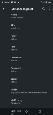

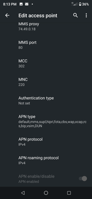

@JL9  see my last response ( I saw your question just after I posted) . My husband's phone had a space before DUN that should not have been there, and previously  ( months ago) I could not hotspot from my phone. We found that dun did not work on my phone, it had to be DUN. So I suggest you try checking both of those and possibly retyping the values or checking for spaces and commas that should or should not be there. I will try to attach a screenshot  ( I actually had to take 3 to get all the info in, in Order... A lot of the values in the list are actually empty. The 3 screenshots have some overlap. The MMS proxy and the APN with DUN at the end were the values that were important to check for us, but you may need to check the other values too so I hope this helps.

SUCCESS!!😁
I was taking screen shots of the APN values. Then decided to compare phones side by side myself. On my phone the values were in a continuous line and only wrapped around once to a new line, on my husband's phone the values were in shorter rows and wrapped around to a new line twice. So I thought maybe there was a space at the end of the row that should not be there. Then decided to try changing DUN to dun myself,  and see if it would let me..... When I deleted DUN it looked like there was a space before I typed dun so I back spaced again and there was a space ( it did not look like an extra space originally, but I guess it was) so I just typed DUN again and saved it... It allowed me to save it (this time)  I hotspotted it then tried connecting with my phone and IT WORKED!!! 😁.....so I guess sometimes it's hard to tell there is a space that should not be there, in those long lists of tiny letters and commas and spaces/ no spaces lol.

Can you provide images of your apn settings. Top to bottom.
