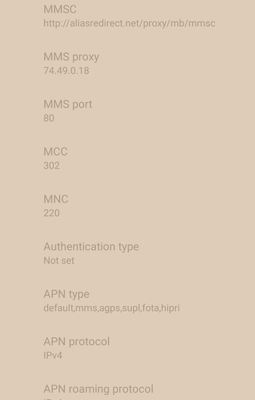

It stinks because my phone won't even allow me to add new APNs let alone edit them. Still waiting on Umidigi tech support to get back to me. I suspect I will be buying a Freedom Mobile SIM soon... No outlets in Quebec but I can probably get one shipped.
APN = sp.mb.com
MMSC = http://aliasredirect.net/proxy/mb/mmsc
MMS Proxy = 74.49.0.18
MMS Proxy Port = 80
MCC = 302
MNC = 220
APN Type = default,mms
Works fine for me. And for all my referrals. If Public Mobile (Telus) actually changed anything then they haven't made these years-old settings "obsolete".

@hTideGnow- I have a Moto G5 plus. APN info is:
But from what I’ve been told by customer service these settings are correct.

Stephen, I have news... Some good and some bad:
  • The issue is indeed with the APN settings. As was suggested earlier here (I think), the mmsc proxy should be: mmscproxy.mobility.ca and the mmsc port should be 8799. This was confirmed by a PM tech support rep. This would explain why your switching between sp.mb.com.and telus.mb.com works temporarily. The MMS proxy and MMSC are inputted correctly in the Telus APN but not the default Public Mobile one.
  • One fix suggested by the tech support agent was the following. It did not work for me but it has worked for others: go to https://forums.oneplus.com/threads/1-nord-telus-apn-fix.1476371/ and try adding APN using "shortcut master (Lite)
  • Else the suggestion Softech posted earlier about swapping out the sim card might be the way to go. Here is a how to: https://youtu.be/2rvNpKdSx58

What is your MMS Proxy?  It didn't show.  It should be:
MMS Proxy: mmscproxy.mobility.ca
For MMS Port, instead of 80, try :
MMS Port: 8799
For APN Type:, try
APN Type: default,supl,mms,agps,supl,fota,hipri
