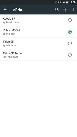

Hi Team,
Finally got my Public Mobile SIM card and activated successfully. Only issue is that while call & text works, data doesn't seem to. Thought it was an APN issue but I checked and it looks fine.
May you guys please assist? Many thanks!
Cheers!

@makkahn28, looks like that fixed the issue, the APN settings that it picked up from my SIM card is slightly different than your settings. When changing it, it fixed it.
Cheers!

Welcome on board, @deltatux
Your APN settings seem to be OK as indicated by the green dot in your screenshot.
Please check if your mobile data is enabled. Also, reboot.
