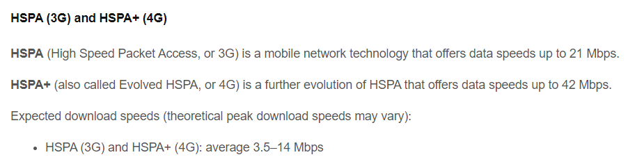

This is what Bell has to say on their website about HSPA/HSPA+:
 I can say without any doubt that HSPA+ isn't a requirement to use both voice and at the same time.  As from earlier, many phones simply only say H when data isn't in use and the symbol changes to H+ when data is in use. As for data only working in H+ mode, there's no way to that I know of to disable tthe faster speed protocol.  A phone would automatically switch the best network protocol, so a phone doing that doesn't mean that it's needed for data.
As for the information provided by Bell, it's not entirely accurate.  HSPA and and HSPA+ aren't two different things.  I would say that HSPA+ is a type of HSPA that  allows faster data speeds.  As for the 21Mbps speed for HSPA, that's not entirely wrong, but the 21Mbps is an HSPA+ speed, just as 42Mbps (so why not just say HSPA can go up to 42Mbps?).  If you wish to go further into that, 42Mbps, while HSPA+, is sometimes more specifically referred to as DC-HSPA.
Basic UMTS should be capable of concurrent voice and data, but the peak speeds are so slow (384 kbps) that it's practically unusable in this day and age.
