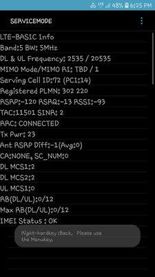

So here's some more. This is antenna off, in a worse reception area
Here's a couple more while rrc says idle, not sure what that means as I moved to better reception area
And saying connected again

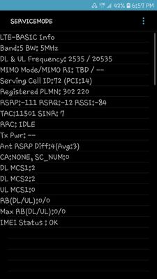

Here's one last one with antenna off, holding it where I would frequently sit. But just holding it while in service mode without anything playing or downloading in the background
Also just to be sure, none of these numbers can be used to sim jack or anything can they? I noticed you had blacked a few of yours out in your screen caps...
Glad you got the band locking sorted. And yeah you need to go back with 3 dots menu and apply any changes.
The first thing I noticed is that when you're in connected mode with no antenna, your TX power is 23 dBm. This is the maximum limit, which leads me to believe your uplink is not strong enough and the tower can't reliably receive your signal. Without a reliable UL, there is no point in having good DL.
Another thing I noticed is your SINR is -16 dB (and RSRQ is -15) with the booster. This is REALLY bad and basically means the signal is unusable due to interference and external noise.
What is the TX power when booster is active? Does SINR fluctuate a lot? Please take measurements only in connected mode with data session active.

Pawprints1986
When it would default to band 13 lte before, it would hang around normally at worse than -126 and often fade right out going back to wcdma. I still have no idea why it defaulted to crappier signal before I got band lock working properly? It's only been this afternoon but I haven't seen it crap right out with this configuration. Except my earlier antenna screen cap.
The only thing I've yet to do is try it mounted on the wall since I'm just trying it out. It's about 1/3 up the wall, back of the couch. I don't know if that could be why the crap outs, or if that's the main outdoor antennas issue ? Being on a building I can't mount on the roof, so I'm seeing what upper window height will do so far
