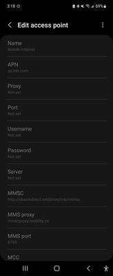

@drewber83  Thanks for screenshots. APNs matches exactly what I have in my Samsung.
If you can edit/change them you could try changing these two below to the following. Instead of MMSC link aliasredirect etc change it to the below and then change port 8799 to port 80.
MMSC proxy: 74.49.0.18
MMS port: 80
