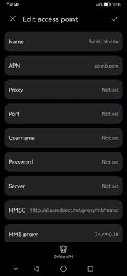

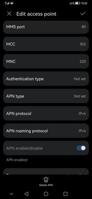

Switched plans a few days ago, now I can't send or receive mms. Android help only.
1. I've toggled things on and off in settings
 2. I've powered off and on the phone
3. I've toggled between the 2 APN's I have
 and
there r some difference between the 2 APN. But both don't send mms. I don't know which is the right one to use either.
Can anyone help?

I suggest you to delete the 2 APN and try to create a new one following these
APN: sp.mb.com
Proxy:
Port:
Username: <blank>
Password: <blank>
Server:
MMS Proxy: mmscproxy.mobility.ca
MMS Port: 8799
MCC: 302
MNC: 220
Authentication Type: Not Set
APN Type: default,supl,mms
         or    default,mms,agps,supl,fota,hipri
           (might need to include DUN for hotspot, please note case sensitive)
APN protocol: IPv4
APN roaming protocol: IPv4
APN enable/disable: APN enabled
                or  Turn APN on/off APN turned on
Bearer: Unspecified
MVNO (Mobile virtual network operator) type: GID
MVNO (Mobile virtual network operator)value: 4D
Also, download Google message and use that as your default app to send message.  if you already have Google message installed,  then uninstall and reboot and reinstall
