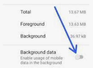

@mobileguy
So you need to turn off those individual app settings...
Turn off auto-sync
  1. Open your phone's Settings app.
  2. Tap Accounts.
  3. If you have more than one account on your phone, tap the one you want to sync.
  4. Tap Account sync.
  5. Turn off the apps you don't want to auto-sync.
When I have data saver enabled it automatically only allows auto-sync to work on wifi. But with a Google phone it must give you more options with individual apps' settings...thus more work to tiurn them off.

@mobileguy
After doing some quick research I’ve found that you’re able to manage you background data usage on each app through permissions. In addition, there seems to be a feature called auto-sync that controls whether or not your phone will automatically start using data, you may want to toggle this feature off. As I’m not a user of this phone model a can not confirm that these will help... but I thought I’d let you know.

@mobileguy did you set your Google Play store to update via Wifi only?
At Play Store, Under General, tap Auto-update apps, enable Auto-update apps over Wi-Fi only
Also, did you check Mobile Data Usage? It might be able to show you which app stole your data.
