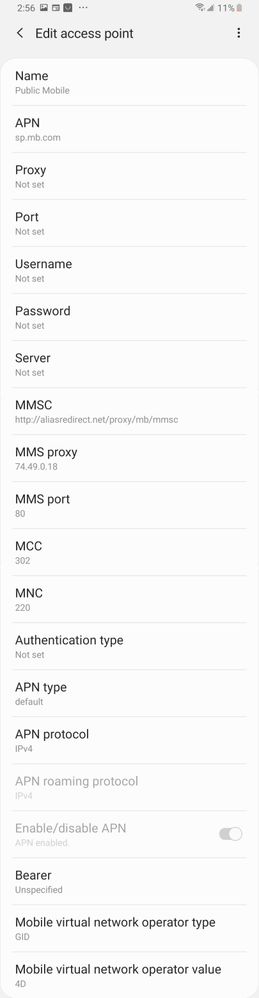

Of course your data is off right?
mordicus
@Anonymous: that is correct I am not able to delete it.  Deleting APN under the 3 dots does not show up for the grey out "mobile internet" setup.  It does for the other setups!
Updates: I decided to try on 2 old phones and the same sim card:
Nexus 5 , Android 6.01 -> it works and I was able to edit and delete the default APN configuration.  sms,supl worked fine!
Samsung Galaxy Core, Android 4.4.2 -> it works and I was able to edit the default APN configuration.  sms,supl worked fine!
Conclusion: I just need to find a way to delete and/or edit the default APN configuration on my Samsung S8+ , android 9

I had a similar problem setting up MMS on the bf's S6....not the greyed out issue but the only way I could get the MMS to work was thru the ethernet APN. It stayed that way for a week or so when I went back in to try and fix his calling ( still not resolved but its a back up phone now....yes the only one he hadn't lost or smashed yet.🤔) I then noticed that I could select the correct pm APN and edit and save it.
I also just noticed my moto g7+ APN settings are all greyed out. It works so I don't want to mess with it but it wasn't that way when I first put my pm sim card in and checked to make sure it was correct and data/MMS as working.
 @mordicus : When I got down to two APN's, the test one and the hotspot one, only the hotspot one was selectable. But mms worked and no browsing. Are you not able to tap into an APN and tap the 3 dots and delete it? I deleted those 2. Then a bunch of other Telus-related APN's showed up. I deleted all those. Nothing. No mms, no browsing. I added back the mms APN and mms worked and no browsing.
mordicus
@Anonymous  : as you may have noticed in my post with the apn configs, the default is grey out meaning I cannot edit it nor can I delete it.  Therefore I cannot have one and only one configuration.
 @mordicus : So not on mobile now and with a little time...I reset to defaults on APN's, made just the one APN with mms,supl...no luck either on my Samsung A31 running A11 with dual-SIM. It simply didn't send out...not changing to default the way you experienced. I don't think this is stored on the SIM specifically. I think it sees the carrier and looks in the device for the matching APN and uses the pre-configured one.
This had worked on my S7 on A8 (single SIM).

mordicus
@Anonymous: When I select the "Public Mobile MMS only" configuration the APN goes to "Mobile Eternet" configuration. If I select "Public Mobile" APN keeps it selected.
Screenshot_20210507-145600_Settings.jpgScreenshot_20210507-145614_Settings.jpgScreenshot_20210507-145731_Settings.jpgScreenshot_20210507-145833_Settings.jpg
Thanks for going through that much trouble.  Correct my if I'm wrong but most of the information configured in APN should match what is stored on the sim card.  Beacuse my sim card is very recent (last week) maybe Public Mobile has changed their sim configuration that would cause this.
Note: "Public Mobile" configuration (that I have created following Public Mobile instructions at setup time) and "Mobile Internet" that was already on my phone work fine.
mordicus
@softechit maybe a solution although I'm able to create a configuration with APN Type "default" that can be selected and it works, with data of course.
BTW, if I changed my newly created file that had APN Type "mms,supl" to "default" than APN doesn't go back to default.  I tried that in case I had some other field worngly configured!
 @mordicus : Please post screenshots of all of this one APN. And a screenshot of the list of APN's.
