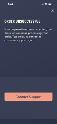

I tried purchasing a physical SIM in the app today, since everything works in device 1. However, Payment went through but got “order not processed” message.  I messaged CS agent, who stated they don’t have access to orders in app, despite the message clearly stated to contact an agent.   I don’t know what’s wrong with PM, none of their products/services work!
