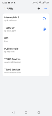

I just activated my new sim earlier today.
I can't access data on my phone. I've created a new access point but still can't access data.
Ive attached a screenshot of my apn settings

Rita257
yes, there's already a Telus access point with those settings. There's also a grayed out Public Mobile access point with the same settings. I've attached the screenshot. So if the settings are correct what else might be needed here?
Rita257
Ulephone note 14. When I was setting up the account the phone was checked and it's supposed to be fine.
