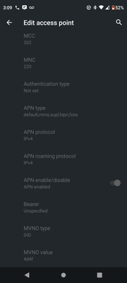

Here is the apn you asked for

What all items do you have in your APN list?
