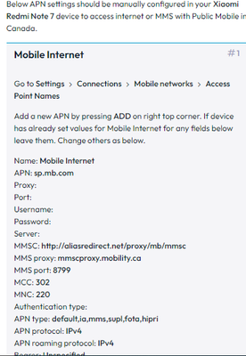

I still can not send/receive image from text message.
my data is turned on. my phone is redmi note 7, and set the APN based on the following:
I could receive and send images before, and I don't remember I have changed anything.
any ideas?

If you can recieve MMS then you should be able to send. Double check your APN for any tiny errors like a missing period or an extra space. Can you post a screenshot of your current APN settings?

try this, look like a bit more than your screenshot (as yours were cut off)
you might want to create a new APN profile, save it properly and select it to use instead of updating the existing one (some people really need to use a new one instead of the update one to make it works)
APN: sp.mb.com
Proxy:
Port:
Username: <blank>
Password: <blank>
Server:
MMS Proxy: mmscproxy.mobility.ca
MMS Port: 8799
MCC: 302
MNC: 220
Authentication Type: Not Set
APN Type: default,supl,mms
or default,mms,agps,supl,fota,hipri
(might need to include DUN for hotspot, please note case sensitive)
APN protocol: IPv4
APN roaming protocol: IPv4
APN enable/disable: APN enabled
or Turn APN on/off APN turned on
Bearer: Unspecified
MVNO (Mobile virtual network operator) type: GID
MVNO (Mobile virtual network operator)value: 4D
