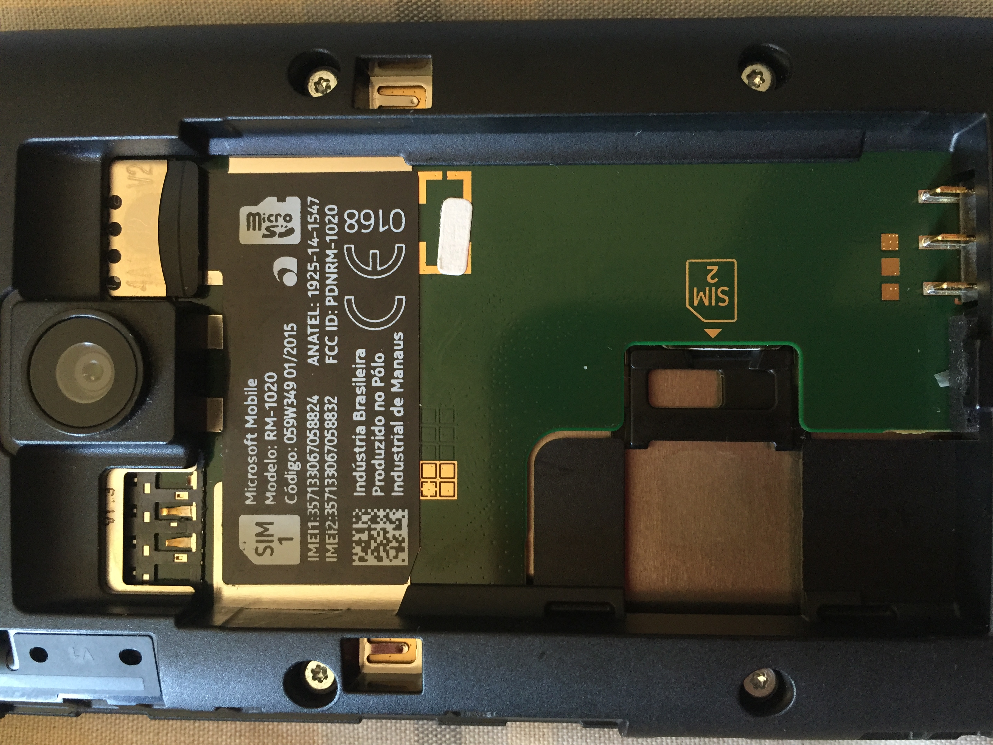

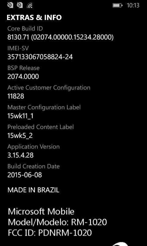

I'm trying to use my sim card on my old Nokia 530, my SIM card is working well on my iPhone 6 and my Nokia is unlock.
I'll show some prints of my nokia, hope someone can help me.

I did some tests and the only way to generate the "No SIM" message was with no sim installed, or the sim installed incorrectly. With inactive SIMs from three different carriers the message was "No Service".
Therefore either your phone's sim contacts have failed or you accidently reassembled the nano sim into the micro frame incorrectly.

I found this information about your phone frequencies that suggests it only has 1 of the 3G (UMTS) frequencies (850). I don't know if this would make the PM sim incompatible. Will keep looking.
  • Other names
    RM-1018, RM-1020
  • GSM frequencies
    850 900 1800 1900
  • Standard UMTS
    850 900 2100
Thanks for the update. Have you ever used this phone in Canada? I am really wondering if it is either locked to a Brazil carrier, or just has the wrong frequencies.

OK here's some additional grasping at straws:
a) check for corrosion on the sim contacts in your phone & clean them,
b) try a different carrier activated sim card,
c) scotch tape on the back of the sim to tighten the fit,
d) do a complete factory reset,
e) get a new PM sim.

Since your phone is dual SIM, have you tried the PM SIM in both slots?  Any difference between them?

Mmm, nice link @Luddite, my phone should work.
Some Lumia 530 models are not compatible with PM's network. You will need to look up the exact sub-model for be sure. This is the report from http://willmyphonework.net
Nokia Lumia 530 - Carrier Frequencies Canada, Public Mobile
RM-1019 Dual SIM
ResultCarrier Network does not support 2G
Result Device not compatible
Result Device does not support 4G LTE bands
RM-1020 Dual SIM
Result 850MHz, 1900MHz
RM-1017
RM-1018
andreaamado
In Brazil, I bouthgt unlocked.

Hi @liamandrew94, yes I'm using the card with the PM adapter fixed, I removed many times, I updated my old phone, tried in both ports and the card is perfect and working well on my iPhone 😞
liamandrew94
Hi @andreaamado, just some clarification questions:
- Are you using the correct size of SIM card?
- Have you tried removing the SIM card, closing the tray, and reinserting?
- Have you tried placing the SIM card in the tray in all possible ways?
- Is there any debris or dust in your SIM card compartment?
