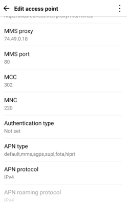

 @momneedscoffee : If this is an Android then please post screenshots of your APN settings. Maybe an eagle-eye will see some subtle thing. Or other things to try.

Capture+_2021-04-17-13-45-03.pngCapture+_2021-04-17-13-44-51.pngI went through and updated my APN to what is listed here, and still cannot send picture texts.  No issues iwth internet....just pictures won't go via texting.  Thank you.

Triguy
Make sure you have the correct APN settings.
APN: sp.mb.com
Proxy: Leave blank
Port: Leave blank
Username: Leave blank
Password: Leave blank
Server: Leave blank
MMSC proxy: 74.49.0.18
MMS port: 80
MCC: 302
MNC: 220
Authentication type: Leave blank
APN type: default,mms,agps,supl,fota,hipri
APN protocol: IPv4
APN roaming protocol: IPv4
Bearer: Unspecified
MVNO type: GID
MVNO value: 4D4F
