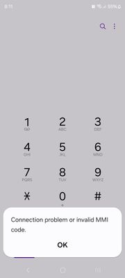

foreverkayla8
The first code tells me I am using band 12.  I get an error with the second code.
sheytoon
@foreverkayla8 are you able to dial any of the following codes on your Samsung to get more info?
  • *#0011# to see which bands you are currently using
  • *#2263# to see which bands are supported
It's a good thing you cannot force it to 5G only. That would make any phone on PM useless as there is no 5G SA service.
