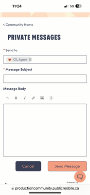

@Alissa1  It’s autofilled to send to agent just tap my the link and type message and send message should look like this
send  a  private message   To CS_Agents
@Alissa1
just submit ticket by direct message

@Alissa1  you trying submit ticket using chat bot ???  You can use this direct link. To submit ticket with support it’s different and will work
