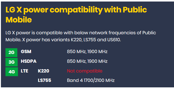

I tried several suggestions posted on old threads relating to the same issue on the same phone, but nothing worked. Someone did mention that the LG X Power does not work with PM's LTE network (pic attached), but I was with Wind and had no network data issues at all.

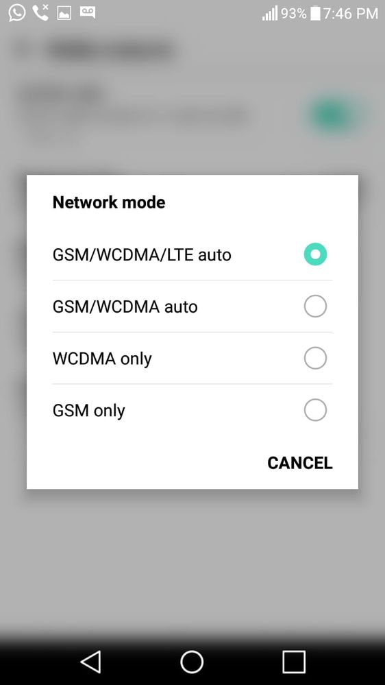

I don't see "HSDPA" within the network mode options. Assuming 3G is GSM/WCDMA auto, that does not seem to work either.

@ksoosiah, sometimes LG phones need a network reset for them to work.  As well there seems to be two models of this phone and one is not compatible with PM LTE while the other is.  On your phone if you select to use a 3G network will it work?  What phone is your husband using  LG X Power.PNG
