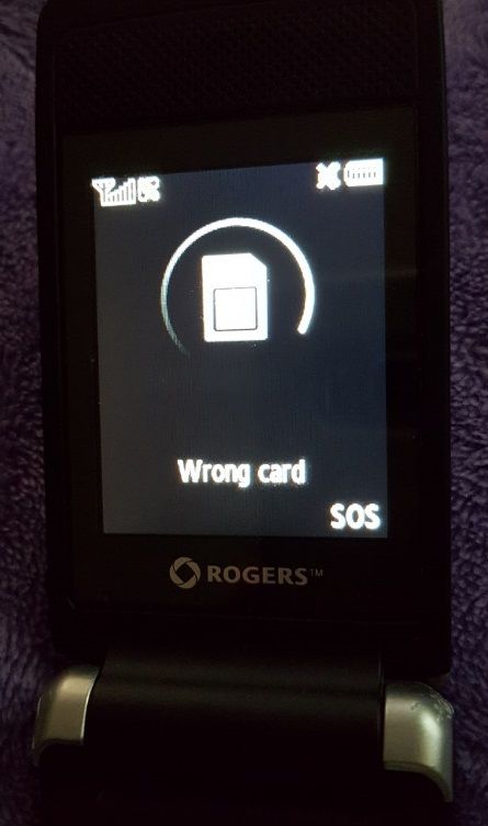

Hi All,
Overview:
- I've recently activated a SIM for the simple TALK only plan. I don't need data nor text messages - we simply need this phone for calls only.
- The SIM has been successfully activated - it works on other phones
- The phone is confirmed - unlocked (former Rogers)
- Phone Model: Samsung SGH-S366 (older style flip phone)
- Phone Specs: https://www.phonearena.com/phones/Samsung-SGH-S366_id3357
- Phone User Manual: https://www.manualslib.com/manual/145004/Samsung-Sgh-S366.html?page=11#manual
Issue:
- This phone seems to take an older style SIM card. (the card size is the same but the chip area is larger)
- When I insert the largest triple punch card - it doesn't register and keeps giving me a "Wrong Sim" error message
Questions:
- Does Public Mobile offer the older larger SIMs?
- What is that type of SIM card called? Can I get the replacement card from one of the distributing stores?
- Is there a work-around for this?
- If this doesn't work - can I get a refund for my prepaid service as this will clearly not work with the phone we need. (We don't want to use a smart phone)
Thanks!
~ V
Chip ComparisonChip ComparisonSIM ComparisonSIM ComparisonError MessageError Message
Insert SIMInsert SIM

The Samsung S366 will never work on Public Mobile even if it is unlocked.  It is a GSM only phone and is not compatible with Public Mobile (nor Bell, Telus, Freedom, Virgin, Koodo).
https://www.rogers.com/cms/pdf/en/Wireless/NewCellPhone/Samsung_S366PayAsYouGo_En.pdf

I just plugged the original Rogers SIM back in and it detected it right away so I'm thinking it's the sim card size/slot issue? The chip on that card is slightly larger so maybe it won't function with the newer sims?
I can only access the phone if the SIM is detected, else it only allows me to SOS call. So using the old sim - it says "Unregistered SIM" but I can now access phone menu items. I tried to change some settings but it will not allow me to.

@Mindless Have you switched in Settings > Network Mode > GSM only to WCDMA? It is not covered in manual, so you have to search and check that option.
LEGO
@Mindless I have look deeper into phone-supported frequency and this phone does not support 3G. You need a different phone.

Thank you for your suggestions. Unfortunately, I have tried several ways to add thickness (tape and paper/card stock) to enhance the contact of the chip but found no success. I even have a SIM Card Adapter and it doesn't seem to make any difference either (the adapter has a back on it and actually makes the chip area stick out a bit more). The error message remains the same when I turn on the phone so that's why it makes me wonder if the chip size actually makes a difference.

@Mindless, The chip area shouldn't make a difference.  Perhaps you are simply not getting good contact due to thickness.  That is, because you are using the detachable rings, it could be that at the point where the contacts are, the contacts are not being pushed up against the phone properly.  The reality is that the newer , smallest SIM size is also a tiny bit thinner.  If it is safe (don't want it to get stuck anywhere), you could try putting a small piece of tape on the back side, in hopes that this would put some downwards pressure and get better contact.
Don't know if PM sells any of the older style SIMS any more.
EDIT:  Just reviewed your pics, and it looks like a piece of tape won't help.  However, if you put a piece of folded paper or cardboard, it might help.  Anything to give added thickness.
