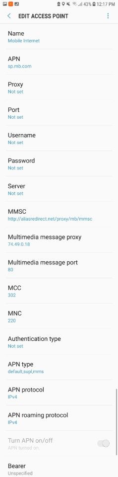

Hello, i switched to public a couple weeks ago and i have noticed that i cannot send or receive any mms messages? i cant do everything else. please let me know what to do! i'm using samsung s7.

Does your mobile data work in other apps? If it does, then your picture messaging should work. If it doesn't, make sure you configure your APN settings correctly. If you don't have data, MMS won't use up any data but it still requires that connection so make sure you have data enabled on the device. APN settings can be found here: https://productioncommunity.publicmobile.ca/t5/Knowledge-Base/Setting-up-Data-APN-on-your-phone/ta-p...

Settings look right.  Try another text app like chomp and see what happens.  See if you can recieve MMS messages.  Oh, and completely power down the phone after you do any changes.  Sometimes the changes do not kicking till after a restart.
