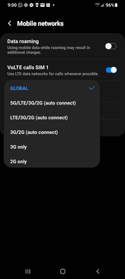

- I selected "GLOBAL" but the "5G" option exists now:

@Questioner5 wrote:Thanks for replying. When I check my mobile network options 5G is not listed. I posted a screenshot above
@Questioner5 , I am only familiar with iPhone’s. Sorry 😞
09-10-2023 08:47 PM
09-10-2023 08:46 PM
There is no 5g option when I check mobile networks. Is this usual for the s20fe?
