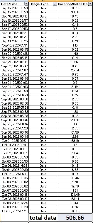

Any one else noticing the data meter on the home screen in the app does not match the daily data counters. My meter says I used .91 Gb so far this period but when I add up daily usage from the history page I only get about 500 Mb. Support agent not understanding whats going on so just says upgrade plan for more data... so frustrating... the agent is making no sense in the responses. Here are a couple of screenshots of the home screen counter and the non matching actual daily numbers for the history page.

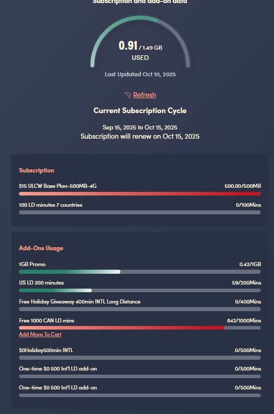

Nope. It says I had 1.49 at the beginning of the cycle and have used .91. WHICH IS INCORRECT!

the meter is correct. The meter tells you the total usable data you have at this time, it has a sum of the current month usage plus those non-expiry addon
yours show 0.91/1.49 GB. The total is 1.49, as you know, you don't have 1.49 new GB of daily each cycle. The 1.49 is a total of the 500 Mb monthly cycle plus the 1GB promo. Since the base is a total of the current + the non-expiring addon, the "top part" of this fraction is also a total of the monthly usage (500 Mb used) plus the data used on the non-expiring addon (0.42GB)
I would say it is not a good representation of the usage but I would not say it is incorrect. It is surely showing the correct info

Since you just used up the 500Mb of your monthly usage and the usage history (506.66Mb) confirmed that, I think everything looks good and correct
10-10-2025 07:51 PM
According to the Usage History, it clearly shows you only used 500 Mb from Sept 15 to now, so what you see showing 461 Mb on the phone matches the 506.66 (there is a slight difference, 40Mb or so, which is normal)
If you are thinking about why there is the 0.42GB used on the 1GB add-on, those was used on previous cycle. If you still unsure, ask PM to help. Use this link to message them

Like in this case , the screenshot below, the odometer on overview page would should 1.11GB/56GB. But clicking on the Usage Breakdown link (not the Usage History page) would show how the 1.11 comes up, only 0.13 from current month of 50GB, and he add up usage from Usage History page on this cycle , he would see 0.13 only as well (i.e, the 0.98 used in previous data add-on would not show usage history for this cycle but would show on the Overview page)
10-10-2025 06:38 PM - edited 10-10-2025 06:38 PM
No, you still don't understand
The usage history shows only this month usage
The 0.91 is the total of usage from two sources, 0.4 from the 1GB old data add-on and the 0.5 GB (500 Mb) you used up this month
Click the Usage Breakdown below the Usage Odometer and you will see what I meant (what you shows about the entries of the usage is NOT what I asked to to past for usage breakdown)

I did post the data usage spreadsheet I made from the history page. It says i only used about 500 Mb

I'm on 500 Mb plan so it used up all the 500 about a week ago and 400 or so from an old promo add on I had. I only actually used about 500 Mb so far this month wich the history page proves and also my phone setting data counter says about the same...

Do you have only 1GB monthly data? I see you have 1.49GB total data, look like you have 500Mb data from another data add-on.
The 0.91GB included those used for those 1GB from the current month as well as the used data from the other add-on. Click Usage Breakdown and you will see how much from the two
